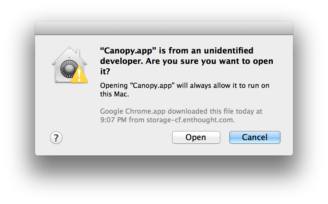

Select open, which brings up the following warning message:
After clicking on Open, you will be asked to authenticate as an admin-level user. Once that is done, the Canopy setup application will open two dialog windows. The first asks where your personal Python setup will be placed:
