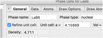

    We will add a phase for LaB6, since this is a simple material we will input this by hand rather than trying to import it. Use Data/Add new phase to create a new phase. Enter any name you choose, though LaB6 is a good choice and press OK.
    The symmetry and cell need to be edited on the new phase's General tab. Click on the Space Group Button (which defaults to P1) and enter P m -3 m (note use of spaces to separate symmetry axes – though in this case since this is a standard setting, omitting the spaces works too. The space group symmetry information is displayed, click OK.
    Change the lattice constant (a) from 1.0 to 4.15689 A. (The value for SRM 660b)
    Finally add atoms to the phase by clicking on the Atoms tab. Use the Edit Atoms/Append atom menu item to insert an atom. A new atom is included in the table.
    Double-Click on the Type value (H) and which opens a periodic table window. Click on the arrow next to La to bring up a menu of the defined valences
    Select La (neutral atoms are usually preferred) from that pull-down and the period table window closes. This atom is located at position 0,0,0 so no further editing is needed. For completeness add the second by using the Edit Atoms/Append atom menu item again. to insert an atom. For the second atom, change the type to boron by Double-Clicking on the Type value (H) and selecting B (the only choice) from the pull-down. The coordinates for this atom are 0.1975,0.5,0.5 so the x, y and z values must be edited.
    Note that the site multiplicities indicate that the stoichiometry is La1B6, as is expected.
