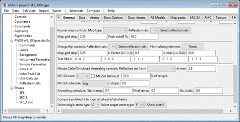

    Step 11. Polyhedral comparison for the big box model
    In this step we will examine how the suite of PO4 and GaO4 tetrahedra deviate from an ideal tetrahedron. This analysis is currently restricted to structures with P1 space group symmetry; this is what we have from Step 9 above. Select Phases/GaPO4-X_1 from the data tree; the General tab will appear.
    What we want is at the bottom of this panel; scroll down to the bottom
    At the very bottom is the control for polyhedral comparison. All that is needed is to select the central atom (“origin atom type”) and the polyhedral vertices (“target atom type”). Select P for the former and O for the latter. Then do Compute/Compare from the menu; a popup for setting Distance Angle Controls will appear
    In some cases the bond search factor may need to be adjusted to get the right number of vertices for the polyhedra; in this case 0.85 is fine (NB: in this use the angle ranges are ignored). Press OK; a progress bar will show the atoms being processed. The console may show some atoms being skipped because the number of vertices wasn’t either 4 (tetrahedron) or 6 (octahedron); all but one are ok here. Because there are 432 P atoms to be looked at in this big box model, this calculation can take a number of minutes. The General tab reappears already scrolled to the bottom
    A new button (Show Plots?) has appeared after the atom selections; press it. A number of new entries will appear on the plot window; we will discuss each in turn. Select the Tet P-O Bond for GaPO4-X_1 tab
    This gives the distribution of the average P-O bond lengths for all the tetrahedra found across the big box model. It is rough because of the small size of the model, but the asymmetry seen in the RMCProfile-III is not present in this P-O bond distribution. The console will have listed the average value with the standard uncertainty in parentheses.
