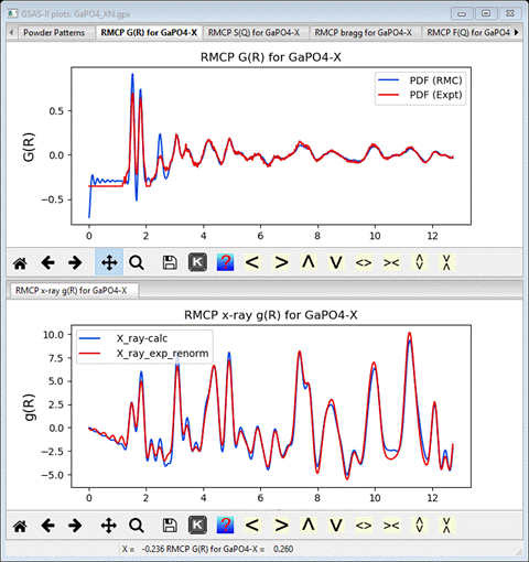

A
comparison of the neutron G(R) (top) and the x-ray g(R) (bottom) show
reasonable agreement between the RMCProfile model and the data – probably could
be better with a larger box model (and many hours of computer time!).

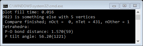

this step we will examine how the suite of PO4 and GaO4
tetrahedra deviate from an ideal tetrahedron. This analysis is currently
restricted to structures with P1 space group symmetry; this is what we have
from Step 9 above. Select Phases/GaPO4-X_1 from the data tree; the
General tab will appear.
What
we want is at the bottom of this panel; scroll down to the bottom
At
the very bottom is the control for polyhedral comparison. All that is needed is
to select the central atom (“origin atom type”) and the polyhedral
vertices (“target atom type”). Select P for the former and O for the latter. Then do Compute/Compare from the menu; a popup for
setting Distance Angle Controls will appear
In
some cases the bond search factor may need to be adjusted to get the right
number of vertices for the polyhedra; in this case 0.85 is fine (NB: in this use the
angle ranges are ignored). Press OK; a progress bar will show the atoms being processed. The
console may show some atoms being skipped because the number of vertices wasn’t
either 4 (tetrahedron) or 6 (octahedron); all but one are ok here. Because
there are 432 P atoms to be looked at in this big box model, this calculation
can take a number of minutes. The General tab reappears already scrolled to the
bottom
A
new button (Show Plots?) has appeared after the atom selections; press it. A number
of new entries will appear on the plot window; we will discuss each in turn.
Select the Tet P-O Bond for GaPO4-X_1 tab
This
gives the distribution of P-O bond lengths for all the tetrahedra found across
the big box model. It is rough because of the small size of the model, but
there is a definite asymmetry in the P-O bond distribution. The console will
have listed the average value with the standard uncertainty in parentheses.

more plots will be added to the plot window. I show both sets of tetrahedral
bonds as a stacked plot; the Ga-O bonds are also skewed but to the shorter side
as opposed to the P-O bonds.
