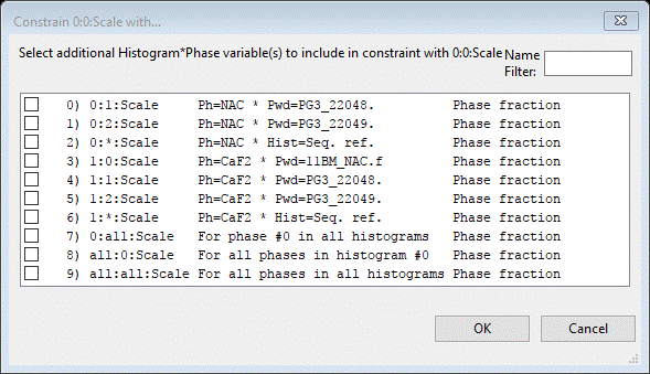

Select the Histogram/Phase constraint tab; the window is still empty. What we want to do is constrain the sum of the NAC and CaF2 phase fractions to be one for each histogram. GSAS-II will apply these constraints to the values during the refinement; unlike in older programs (GSAS, TOPAS & FULLPROF) we do not need to preset the values. To begin do Edit Constr./Add constraint equation from the Constraints menu; a popup window will appear
All the possible phase/histogram variables are listed. The prefix to each name indicates the phase (p) and histogram (h) for that parameter as p:h:name. The phase and histogram numbering begin with zero. The text following the name identifies the particular phase and histogram for each parameter along with a short description. Here we want the phase fraction for NAC in the 11BM data set (0:0:Scale); select it and press OK. A new popup window will appear with all the parameters that could be constrained to the 1st one chosen, here only Scale parameters
Here you can select one or more parameters to form the constraint. In this case we only want 0:0:Scale and 1:0:Scale so that the two phase fractions are constrained just for the 11BM data. Select (check box) for 1:0:Scale and press OK. The constraint will be shown on the Constraints window
The constraint is that the sum of the phase fraction is one. You can edit the constraint changing multipliers and sum if need be, but that is not needed here. Now repeat the process for each of the neutron TOF histograms; constrain 0:1:Scale and 1:1:Scale for the PG3_22048 data and 0:2:Scale and 1:2:Scale for the PG3_22049 data. When done your Constraint page should look like.
