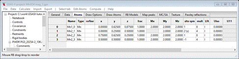

Select Atoms and enter 2.0 for every Mx My Mz allowed for all 4 atoms; it should look like

Select Atoms and enter 2 for every Mx My Mz allowed for all 4 atoms; it should look like
