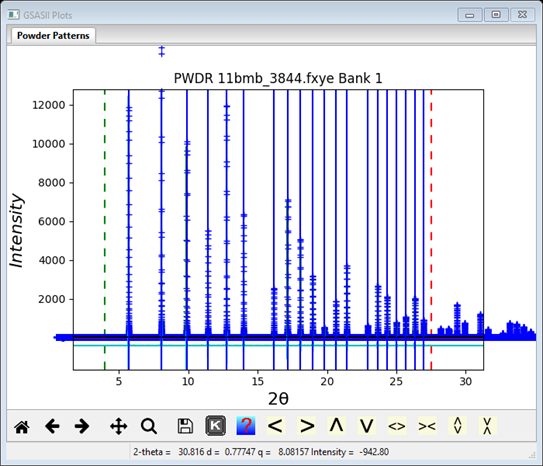

4.      Under Peak Fitting in the menu select Auto search. The plot window will immediately show that all peaks were picked with a blue vertical line on each one
and peaks are shown in the Peak List window in order of increasing 2Q.
There will be 20 peaks in this example. You should examine both the list and the plot to be sure the auto search did not pick a peak twice (rarely) or skip a peak or shoulder. You can add a peak to the list by pressing the left mouse button with the pointer on a data point at the peak top or shoulder; be sure the zoom/shift buttons are off. You may drag a peak position as needed. A position may be deleted with a right click with the mouse on the blue line. You can also delete a peak by selecting the row in the table; it will be highlighted in blue. Then press the Delete key; it will be removed from the table and the plot. The list will always show the peaks sorted by position. When done you should have 20 unique peak positions.
