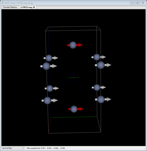

Select the one atom and do Edit Figure/Fill unit cell; the table will list 10 atom positions and the drawing will show
This is an antiferromagnetic structure. Now select the Atoms tab and change Mx=0, My=1; the drawing will update the moments
which is now a ferromagnetic structure. Clearly, this is not correct since we know the material is an antiferromagnet. Therefore, in Pn’nm’ My=0 and Mx > 0. So we should try refining Mx with My fixed. Change Mx=1 and My=0 and select the M refine flag. Then go to the Constraints entry
