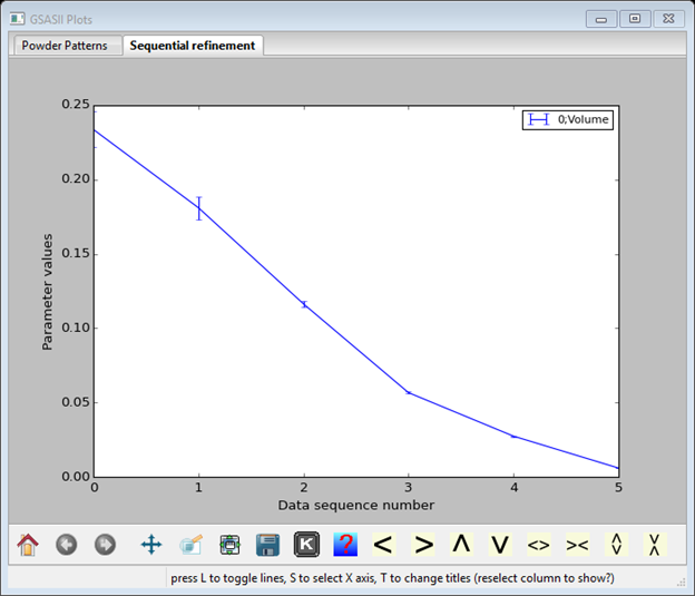

Note the comment in the plot status bar: double click on the 0;Volume and a new plot will appear.
Each point has an error bar extracted from the least squares – it represents a 1 σ variation in the value. Now press the s key (or select s from the K box); a dialog box will appear with a selection of parameters to plot along the x-axis. Select fraction and the plot will be redrawn (it may require selection of another column & then 0;Volume to make it appear).
