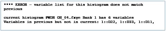

4.      Start the sequential refinement with Calculate/Sequential refine; this will take some time as the refinement works its way through all the histograms.
Note that if the copy operations in Step 4 were not performed correctly, the parameters in each refinement will not agree and the refinement will stop with an error such as this:
Text Box: **** ERROR - variable list for this histogram does not match previous
current histogram PWDR OH_04.fxye Bank 1 has 6 variables
Variables in previous but not in current: 1::D22, 1::D33, 1::D11,
Previous refinement has 7 variables
Variables in current but not in previous: 1::Scale, 1::Mustrain;i,
(This error results if the parameters for the second phase were not copied in part 3 so that the phase fraction and strain broadening are retained for all but the first histogram and the 1::Dii terms are only included the first.)

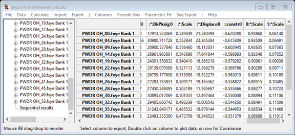

1.      When the refinement completes, a window will be displayed where you are asked if you want to load the results:
After doing OK, the Sequential Results item in the data tree is automatically selected, which displays a summary of the refinement results as a large table.
The second column shows the weighted profile R-factor, from each fit. This shows a steady increase with temperature, as might be expected if there were a systematic change in some sample parameters, such as strain or background or even atomic coordinates (which have not yet been fit). The Δχ2 value in the third column shows the percent improvement in χ2 seen in the last cycle of refinement. (If this changes from 4.1 to 4.0, then the value will be 100*(4.1-4.0)/4.0, or 2.5). Since the convergence criterion in the controls is 0.0001 (or 0.01%) we can see that only one refinement failed to converge. However, these shifts are still quite small, so that there is no reason to provide further cycles of refinement without adding new variable parameters.
Subsequent columns will show any of the sample parameters that vary across the datasets, here only temperature and then the direct cell lattice constants for each phase, generated from the Ax and Dij terms. Scrolling further shows the values of each refined parameter.
Before going further, it is useful to review the trends in the lattice parameters as a sanity check. This can be done by double-clicking on a column of the table, such as the 0::b parameter, which displays this plot:
Pressing the “K” icon or pressing the “s” key brings up a menu where the x-axis can be selected as Temperature. If the plot fails to update, click on another column and then return to the original column.

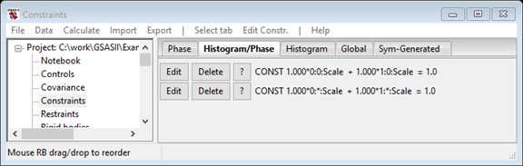

5.      We can now add the phase fractions into the refinement, by clicking on the Phase fraction checkbox in the Phase/Data tab. Do this for each Phase followed by use of Edit Phase/Copy Flags. However, a constraint is still needed as before, but to be applied to each histogram. Constraints entered with a specific histogram number, as was done before, will be ignored. For sequential refinements, only constraints where the histogram number is specified as "*" are used.
To set up the new constraint, click on the Constraints item in the data tree and the Select tab/Histogram/Phase menu item, and then click on the Edit Constr./Add constraint equation menu item. From the menu, we either 0:*:Scale or 1:*:Scale wild card phase fraction; they are at the bottom of each set
There will only be one possible matching variable in the next window, so select that and press OK.
The initial and the most recently defined constraints will then be shown.
These two constraints do not interfere, since the first will be used during a non-sequential refinement and the second is used only for sequential fits, but if desired the first constraint can be deleted by pressing the Delete button for the first one to remove it, but this is optional.
