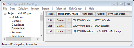

This shows all the possible required constraints between the chemical structure and the magnetic one. The first eight are for the Mn atom; only the Uiso one is probably necessary for this analysis but the others will do no harm. The last three tie the lattices together. Select the Histgram/Phase tab
This gives the constraints between the two phases for scale factors (e.g. phase fractions) and the size & mustrain sample broadening terms. NB: this assumes isotropic modelling of both because the original LaMnO3 was modeled that way. If you want to use one of the more complex sample broadening models, you will have to revisit this tab and put in the appropriate entries to tie those parameters together.
