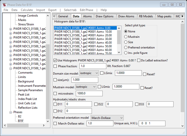

Next go to the Data tab for each phase; there will be a message indicating the lack of data for each. Do Edit Phase/Add powder histograms, do Set All on the popup selection window and press OK. The window for B2 will change to
and that for B19’ will be

Next select the B19’ phase Texture tab. Then select 6 for the Harmonic order and check the two boxes as before.
Then go to the Data tab for the B19’ phase and check all 4 of the Dij boxes and do Edit Phase/Copy flags as before. The tab will look like

Next do the same thing for the B19’ phase; here there are 4 Dij parameters to check (do all of them) and use spherical harmonics order 4. When done that Data window will look like
