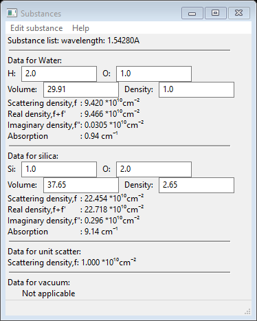

Two substances need to be defined for your sample to give the anticipated scattering contrast; in this case one is silica and the other is water. Parameters for a number of substances are defined in the file Substances.py. You can add your own substances to this or better put them in UserSubstances.py; this is read after Substances.py when you load substances for your selection. Select Substances from the GSAS-II tree. Then do Edit substance/Load substance from the menu; a popup window will appear with possible selections
Notice that silica is not one of the choices; we will add it in a moment. Select Water and press OK; the relevant data for water (and vacuum) are displayed next
If desired, you can load/add as many substances as you want to this list; you can also delete any of them (except vacuum or unit scatter). The composition, volume occupied by the atoms in the composition and the density are given for each substance. These can each be edited; the other values will change accordingly. Since silica wasn’t in the list of known substances, do Edit substance/Add substance to create it; you will be asked for a name – enter silica and then a periodic table of the elements will be shown. Select Si and O
They appear in red. Press OK and silica will be added to your substance list
Change the O-atom entry to 2.0 and the density to 2.65; the window will change each time giving new values and should finally show
From this information the scattering density and that as affected by resonant scattering for the listed wavelength is displayed (the wavelength can be changed in the Instrument Parameters GSAS-II tree item if needed). The real density value is used for contrast calculations.
Just as for Limits, this information needs to be copied to the other SASD entries in the GSAS-II tree. Do Edit substance/Copy substances from the data window menu and follow the same selection procedure as you used for limits above.

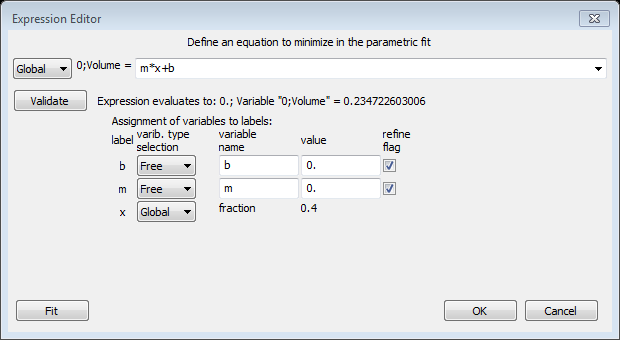

It is gratifying how this relation between Volume and the composition is linear. You can now determine the slope & intercept (or fit to some other function!) directly with GSAS-II; do Parametric Fit/Add equation and the Expression Editor dialog box will appear.
The pull down in the upper left corner has two choices; select Global and a new dialog box will appear giving you choices from the Sequential results table. Select 0;Volume and the Expression Editor will reappear.
Next enter the function you wish to use in fitting 0:Volume; enter m*x+b (equation for a straight line). After a pause, the Expression Editor will be redrawn allowing you to assign b, m & x.
For b & m select Free; these will be the parameters for your fit. For x select Global; a new dialog box will appear giving you several choices.
Select the last line (fraction…); it will appear in blue. Then press OK; the Expression Editor will reappear with more information.
Next press OK; the equation will be fitted to the data and the results displayed on the console
And the plot shows the curve (in blue) calculated from the best fit, weighted by the esds on the data points, to the model equation for a straight line.
