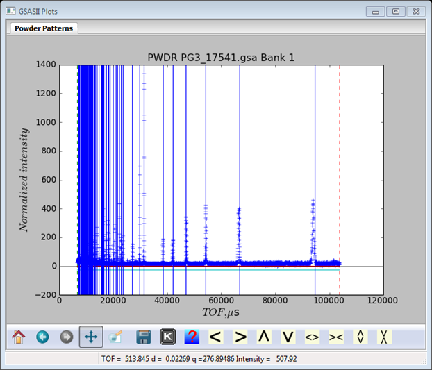

At this point the data tree window will have several entries and the powder pattern will appear. Although it is not necessary in this case, you may wish to change the limits (green & red vertical dashed lines). If so select the Limits item in the GSASII Data tree under PWDR PG3_17541.gsa Bank 1 and set them as appropriate (usually due to unusable data at the ends of the pattern).

Under the PWDR PG3_17541.gsa Bank 1 GSASII Data tree item find the Peak List entry; it will be empty. Select the menu item Peak Fitting/Auto search to populate the Peak List. This will select almost every peak in the pattern (I got 66 peaks).
However, it can fail by selecting a peak multiple times if the data is too noisy. You should check through the list and eliminate any close duplicates (in this instance there didn’t appear to be any). A peak can be eliminated by placing the cursor on the vertical blue line and pressing the right mouse button; the line should vanish and the entry in the table deleted. Notice that the position for the highest TOF peak is misplaced. You can shift it by placing the cursor on the blue line and with the left mouse button down, drag the line to match the peak top (zooming in before can help). If you want you can add more of the unpicked lines to the list (I didn’t). To do this (zooming in helps) place the cursor on a data point at the top of a peak and press the left mouse button. It is easiest to proceed from right to left so the tool tip stays out of the way as you work. For any of these operations the zoom buttons at the bottom left of the plot window must be turned off (NB: one is turned on in the above plot).
