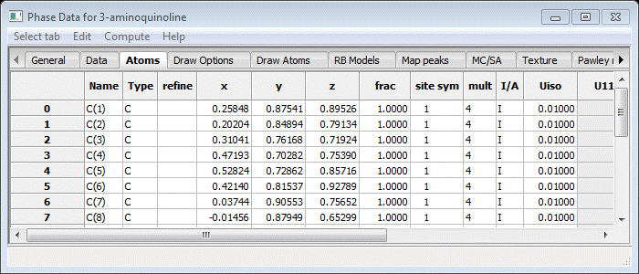

(https://www.ccdc.cam.ac.uk/Solutions/FreeSoftware/Pages/FreeMercury.aspx). To save this solution to the Atoms list do MC/SA/Move MC/SA solution; the drawing will show the new atom positions
And they will be listed in the Atoms table.
