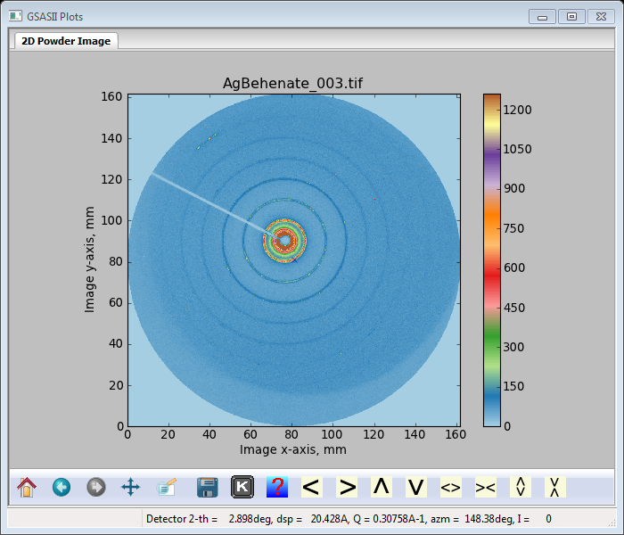

The detector position is determined by using an image collected from silver behenate; do Data/Read Image data… and a file selection dialog box will appear. Go to exercises/SAimages and select AgBehenate_003.tif with either a mouse button double click or Open; the image will appear
And the Image controls window will show
Note the default Type of image data is PWDR - powder diffraction data; you will change that now. Select SASD – small angle scattering data (the window will change). Enter the wavelength (1.0332), and select the Calibrant (near bottom of window) as Ag behenate. Note that the calibration info for Ag behenate was read from a python file – GSASII/ImageCalibrants.py. If you have a calibrant that isn’t in this file you should enter it in the file UserCalibrants.py; just follow the format of the examples within ImageCalibrants.py. You should move the Max intensity slider to near the middle of the range – that will improve the image. When done the Image controls window should look like
And the image will be
Next select Operations/Calibrate from the Image Controls menu; a bit of instruction will appear on the status line of this window. Select 5 points on the innermost ring (arrowed above); a small red cross will appear at each selection point. Press the right mouse button to finish; calibration will proceed. A sequence of concentric red rings will appear; they will switch to blue when calibration is finished. Select Show ring picks (near bottom right of Image Controls window). The Image Controls window will show the results of the calibration
And the plot will show the points (very sparse!) used in the calibration calculations.
You would like to use more points from just the visible rings. I suggest you change Min ring I/Ib to 0.5 and Min calib d-spacing to 10.0. Do Operations/Recalibrate; more points will be used and they will be limited to the 5 visible rings in the pattern.
