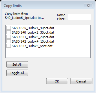

To copy these limits to the other data sets use the Edit/Copy command from the data window menu; a popup window will give the selection of targets.
Do Set All (all boxes will be checked) and then press Enter to do the copy.

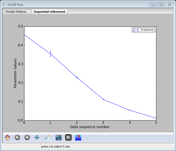

Note the comment in the plot status bar: double click on the 0:Volume and a new plot will appear.
Each point has an error bar extracted from the least squares – it represents a 1 σ variation in the value. Now press the s key (or select s from the K box); a dialog box will appear with a selection of parameters to plot along the x-axis. Select fraction and the plot will be redrawn (it may require selection of another column & then 0:Volume to make it appear).
It is gratifying how this relation between Volume and the composition is linear. You can now determine the slope & intercept (or fit to some other function!) directly with GSAS-II; do Parametric Fit/Add function and the Expression Editor dialog box will appear.
