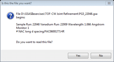

Now we’ll import the 1st TOF powder pattern; do the same Import command as above and pick PG_22048.gsa. The Is this.. window will show
Note that this is the 1.066A time frame. Press Yes; the instrument parameter file dialog box will appear but nothing seems suitable.

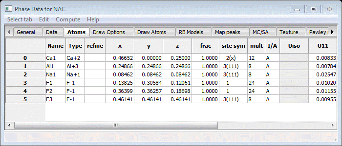

Now that all the nonstructural parameters seem to be dealt with, we can include the crystal structure parameters in the refinement. Select the Phases/NAC entry from the GSAS-II data tree and choose the Atoms tab; the Atoms table will be shown.
To refine parameters double click the refine column heading; a Refinement controls popup will show.
Select both X-coordinates and U-thermal parameters and press OK.  Do not be concerned about atoms on special positions, GSAS-II will determine the refinement rules for these. The Atoms window will show the selected flags.
