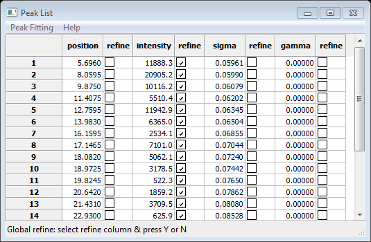

1.      Refine the peak intensities and the background. These parameters have their refinement flags turned on by default. Use the menu item Peak Fitting/LSQ PeakFit on the Peak List window. Do NOT use the Calculate/Refine menu item in the GSAS-II data tree window; that it to be used for Rietveld/Pawley refinements. You will be asked to save the current project before the fit will proceed; change directory if desired and provide a suitable name (we assume LaB6). A window will show the progress of the refinement and will close when the least-squares fit is complete (usually very fast). The plot is updated with the fit, the peak list window is updated with the new peak values and a summary of the refinement is shown on the console window as well.
2.      Now add refinement of the peak positions. This can be done by clicking on all the refinement flags for the individual peaks or it is possible to set them all at the same time using this recipe:
a.       single-click on any value in the table to select it, for example the first peak position. A black box appears around the value.
b.      single-click on the refine label above the peak position check-boxes. The entire column of checkboxes is highlighted in blue. Press the y key to turn on all refinement flags (n would turn them off).
Next, repeat the refinement using the Peak Fitting/LSQ PeakFit menu item in the Peak List window.

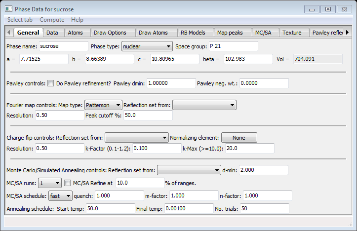

Notice that the lattice parameters and space group have been set for you. If you set the space group here a dialog box will appear.
This concludes this exercise; Save the project file as it is needed for the Charge Flipping exercise. The features of the Phase Data window will be presented in other exercises.
