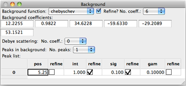

Also click on the Background entry for the PWDR OH_00.fxye Bank 1 entry in the data tree (you will likely need to click on the triangle to the left of the entry to “open” the tree item.) Confirm that Background function should already be set as chebyshev and the Refine flag should be checked. Change the “No. coeff.” entry from 3 to 6 to introduce more background terms.

Once the fit has been improved we can then add the position of this peak to the fit.
While in other projects I might postpone this until later, we can also start on improving the peak fit. We will do this by varying the sample broadening for the major phase (since the instrumental terms are very good.) Click on the first phase (CuCr2O4) and Data tab, click on the Cryst. Size and microstrain parameters to add those parameters to the fit.
There are now 20 refined parameters and a repeat of the fitting (Use the Calculate/Refine menu item) causes the fit to improve to a wR of ~16.
12.  We can now include the position flag for the background peak in the refinement. Do this using the Background item, as before. Be sure to click on some other box after clicking on the refine flag, so that the setting is recorded.
Close examination of the pattern shows that the peak widths are still not as well fit as desired. Since strain broadening seems more significant that sample broadening, we could use an anisotropic strain model. Rather than choosing the relative complex generalized model, we can introduce only two terms with the uniaxial model.  Trial and error will show that the 010 direction works best. Click on the first phase (CuCr2O4) and Data tab and select uniaxial for the Mustrain model and use “0 1 0” for the Unique axis, HKL . Select refinement for both Equatorial and Axial mustrain.
Repeating the refinement causes the wR to drop to ~14%. Clicking on the Covariance data tree item shows that the goodness of fit (GOF) is 1.1 (corresponding to a reduced χ2 of 1.2) with 23 refined parameters. While atomic parameters could now be refined, as shown in the plot, this is clearly a good enough place to start refinement with all the datasets.
